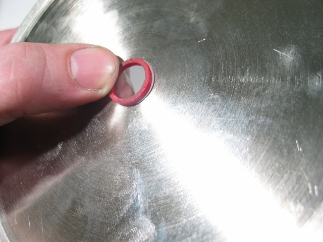

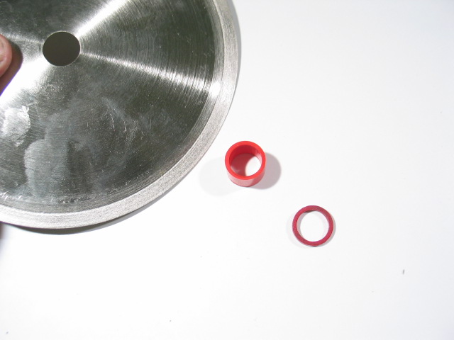

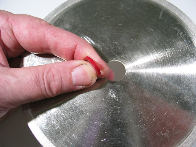

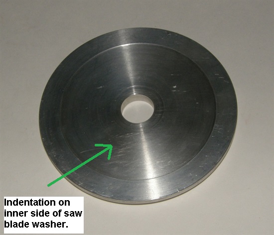

As long as I don't cut polychrome jasper I am OK with my plain Chinese green 16" blade on my Covington 16" slab saw. This is a segmented blade so less expensive and doesn't last as long.
I like the MK lines also for my 6" and 10" saws.
Also check out my method of bushing blades to different sized arbors.
This idea solves the old problem of thin bushings falling out of the hole in the blade. This works when you use standard flange type washers to secure your blades. Each flange has an indentation and you match the thickness of the bushing so it makes contact with the inner flange surfaces at the same time the outer flange edge is tightened to the blade. So the bushing sticks out slightly on both sides of the blade and can't fall out.
This method has solved all my bushing issues forever.

I've never tried plastic wheel bushings in saw blades.  The brass blade bushings can be kept in place by inserting bushing in blade hole and using a center punch (or big nail) ding the contact point of blade to bushing in 4 or 5 places.  I have used the shims inside the flange washer for small thin blades before.
