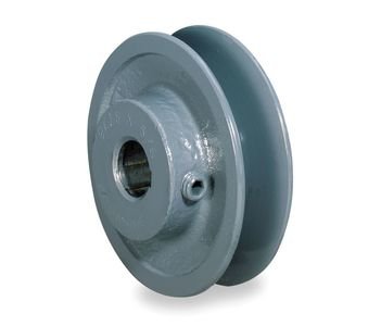

OK got tired of warped and worn weak pulleys on my slab saws so upgraded to cast iron.
And they seriously ROCK.
A bit heavier than normal steel or aluminum so take a bit more electricity to run but that is offset by their longer life span and less maintenance.
Note I searched for a LONG time to find the arbor pulley for my LS-12 because the Lortone .pdf file says it's a 4in x 3/4in pulley. But it's actually 3.95in so searching for 4in is a huge waste of time.
My loss is your gain though since you saw this post.
 :icon_sunny:
These babies are worth the extra money and appear to be heavily coated with (enamel?) for corrosion resistance.

Here you go. These links are for the Lortone LS-12 slab saw which I just updated. My other saws already have the better pulleys. (Covington 16in and Lortone LS-10, 10in)
LS-12 arbor pulley
https://www.amazon.com/gp/product/B007YLTRXY
LS-12 Motor pulley
https://www.amazon.com/gp/product/B003N17JKC
Note: These are also usually available on eBay so shop around for best deal.
eBay can be faster since after payment the better sellers have to ship within 24 hours after payment. Amazon is slower especially when you choose free shipping as an option.
For eBay buy from sellers with at least 50 ratings and at least 99% positive feedback.
In the above example the only place I could locate the 2.25in pulley was on Amazon.
Note also the part numbers since there are more than one groove size. Usually for lapidary you want the 4L size which also equates to "A" belts. I went with Amazon for the 3.95in size since the part number matched better than the eBay auction and price with shipping was the same.
It also might be possible to buy these pulleys on bigger internet websites like Grainger and MSC but I like using Amazon or eBay due to their return policies.
For belts the sizes are:
LS-10 is 4L-320 belt
LS-12 is 4L-360 belt
Covington 16in is 4L-420 belt (This is the budget Covington 16in which I bought many years ago so check your part numbers and .pdf files to match any current models.)
I bought the lower priced belts on Amazon but would be curious as to what others are using since there are more expensive rubber woven belts that are more durable. The issue is the cost to replace belts if they get burnt up when a blade gets stuck.
https://www.amazon.com/gp/product/B00E42BRF2
https://www.amazon.com/gp/product/B00NUQQR9E
https://www.amazon.com/gp/product/B00E42C4W2

Update: I just noticed the 3.95in pulley referenced above is made in China which is still probably OK. But if you want the USA made TB Woods version here is the link:
https://www.amazon.com/gp/product/B003N17KQU
With S&H it's about $10 more than the China pulley.

   Nice, but are you going to share where to find these beauties.......?
I recently purchased this pulley off of Ebay, it was considerably cheaper than AMZN's.
https://www.ebay.com/itm/1VL25-1-2-Cast-Iron-Pulley-2-1-2-X-1-2-Bore-Double-Groove-3L-4L-A-5L-B-Belts/153143107092?ssPageName=STRK%3AMEBIDX%3AIT&_trksid=p2057872.m2749.l2649
