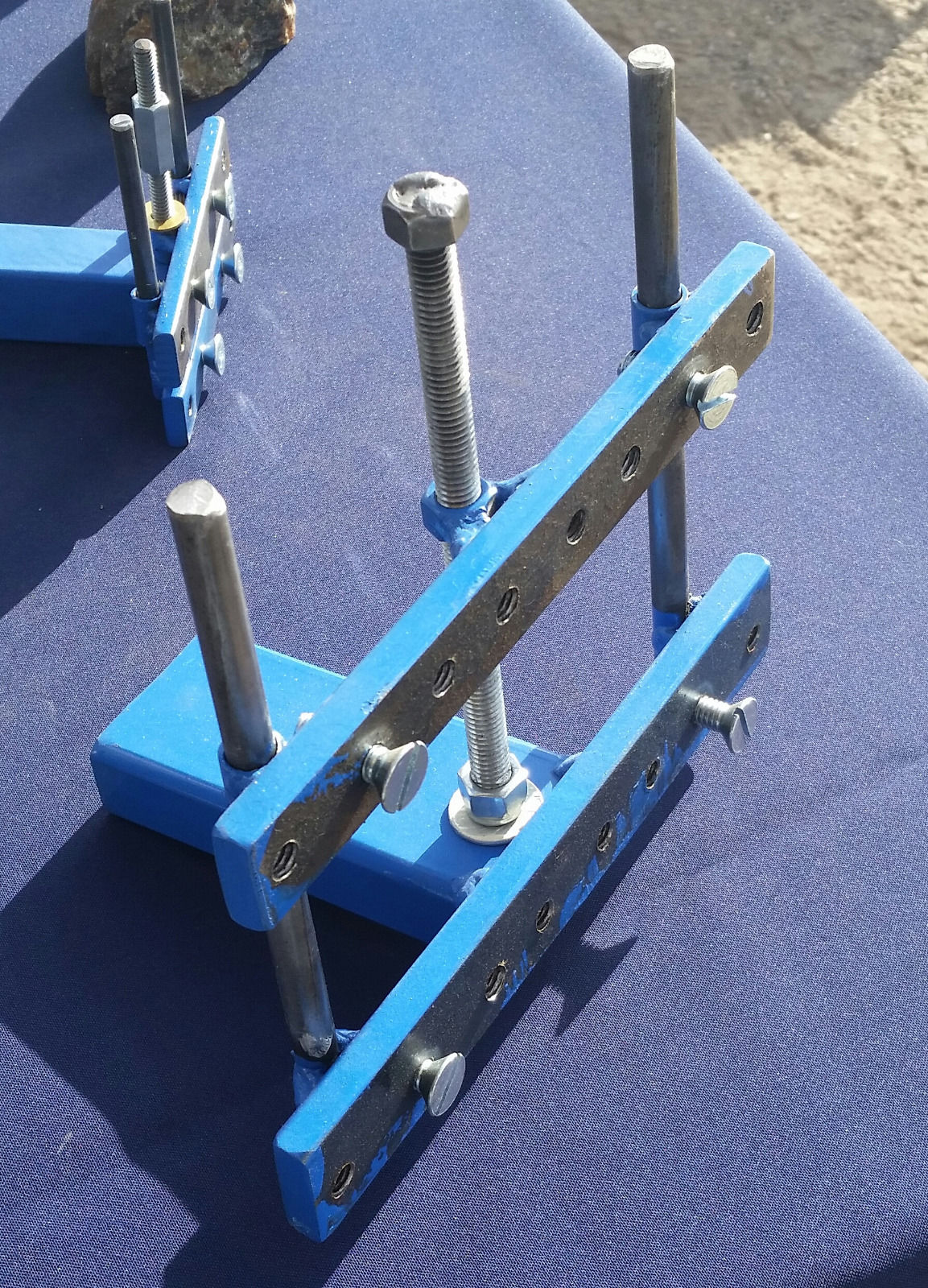

Here is a photo of my rock gripper in action on an 18" saw.
Bob

The builder also made/makes? a larger version that he sold/sells? on eBay. There was a whole thread on these in the old forums. The one pictured is awesome and is designed for smaller end cuts and a 10 inch slab saw.
The larger one was designed for bigger end cuts and bigger saws.
Edit Update: The guy IS still on eBay! You should get one each of these before he disappears again.
Here is a photo of the larger clamp he makes:
http://www.ebay.com/itm/MEDIUM-ROCK-CLAMP-for-12-to-24-slab-saws-Holds-end-cuts-hard-to-hold-rocks-/231944128776?hash=item3600f28908:g:b1UAAOSwmmxW6XL~
http://www.ebay.com/itm/SMALL-ROCK-CLAMP-for-trim-small-saws-Holds-end-cuts-hard-to-hold-rocks-/231948451424?hash=item3601347e60:g:DocAAOSwyQtV4oeV

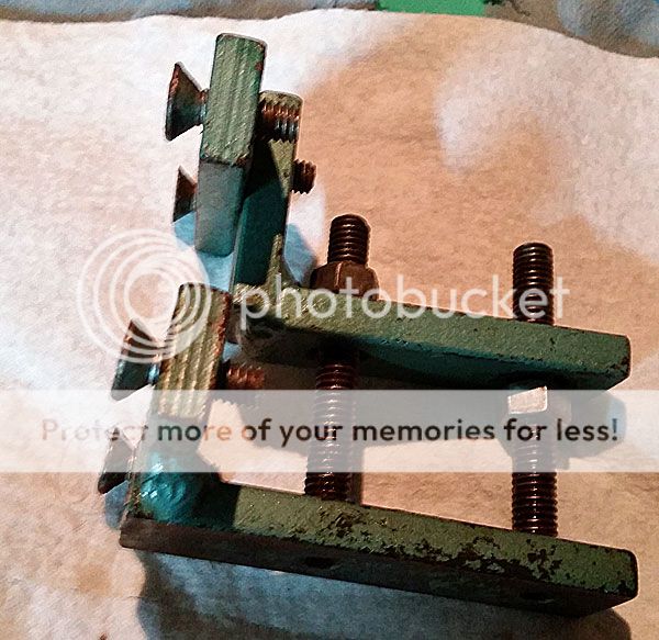

Not exactly a slab grabber, but rather a dopping system for cutting odd shaped pieces or flat faced pieces. An oldie but a goodie.
It starts with a vintage dop pot from the Gemstone Shop, now long out of business.
About 2 weeks ago I found this accessory for the dop pot which I've been searching for since the late 90's. This one just happened to be NOS, still in the box with original instructions. These are used by melting dop wax in one of the 3 cups on the right. These cups fit the dop pot for melting. The rock or faced piece to be cut is placed in the appropriate cup of wax, and the dop pot turned off to cool. When cool, the pot is screwed into the larger piece next to the box. This is clamped into the saw vice for slabbing. When finished slabbing, clean the cutting oil off of the piece remaining attached too the dop. Throw the dop & rock nub in your freezer for about an hour and the rock will fall right off of the dop wax.
The 2 wax pots which came with the dop pot will also work with the slab saver system.

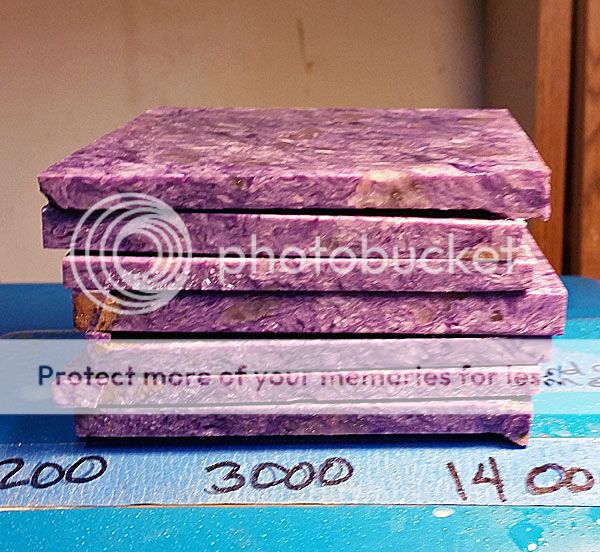

I would agree that charoite probably works better with the wood idea but this is an extremely rare example of a rock that breaks and splinters if you look at it wrong. Plus how many times will you even have a block big enough to slab? It's expensive. Maybe Larimar would be another example but I don't buy that pain in the ass rock either.
I suppose anything can be justified with a unique example but for me 99.9999% of the time my slab grabbers do the job faster and better than messing with glues and sticks.
