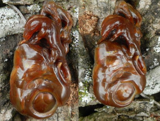

Next up was another JEBEREDHIAH FA
This one started with peeling onions a while back.
Did not get far with the colors as every-time I thought I could settle on something, something larger peeled away giving me a completely new picture. So I decided to keep what I've got and do some carving instead.
Here are some stages
A few angles of the salamander
Have not seen sun in a while, so this will have to do as the best picture from the last couple of days
A size comparison with my son who is pretty much as big as me.
But lets save the best for last:
The pictures above are all taken the way any viewer would see them. When I look down on the pendant while wearing it, I get much stronger color and metallic effect.
And best of all: Not the fire I'm afraid. But something just as mesmerizing. The chalcedony or is it sard, that is nearly void of the brown color. Its that layer that is vexing me since months now on this material, because it alters the colors underneath according to thickness, and its translucent property does not allow perception of depth. But,......... when light hits the piece from above, it seems to literally illuminate the whole of the salamander from within and makes it stand out.
